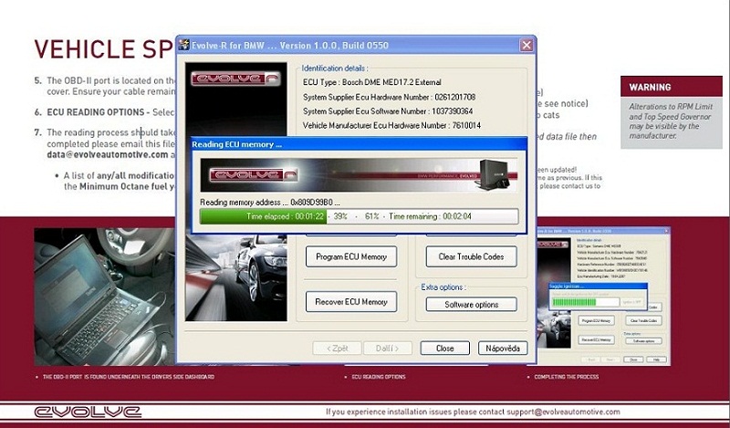

Evolve-R doplnenie info aby bolo pre prípadného záujemca kompletné
Celkom jednoduche napojenie cez OBD do Mini a USB do PC, instalacia SW na PC par minut...
Potom dojde k napárovaniu evolve-ru a ECU a potom už len citujem manuál
The reading process should take no longer than 3 minutes. Once completed please email this file to
data@evolveautomotive.com along with the following details:
• A list of any/all modifications you have on your car as well as
the Minimum Octane fuel you will be using
Your choice of the following:
• Rev limit raise - Yes/No (please see notice)
• Top Speed Limit removal - Yes/No. (please see notice)
• CEL removal - removes CEL if you have no cats
Allow upto 48 working hours for receipt of your tuned data file then
load in using the same system as above.
