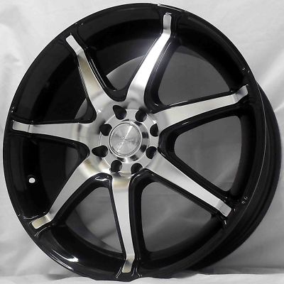

!B+mUho!BWk~$(KGrHqYOKkYEznEZ9ykKBN!KRd6M1!~~_1.JPG [ 27.3 KiB | Zobrazeno 16323 krát ]
18" MINI 06> COOPER D GRAPHITE LEAGUE VIRTUOS
Tyhle bych si nechal na jaro/leto libit uplne bez problemu :D
