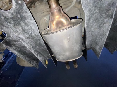

vypis veci na Mini r53, na nektery veci jeste cekam....

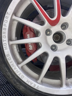

engine:
JCW intake 380cc
Airtec intercooler performance mark2
Airtec induction kit foam filter
CravenSpeed pulley 0%
Alta pulley 15%
Lohen idler pulley
Lohen alternator pulley
Lohen belt tensioner pulley
TPE precision charge pipe V2
Detroid tuned bypass valve
PRO hoses hose kit
Gravity strut brace
Newman camshaft ph1/2
Quality waterpump
Mod a Mini dipstick
Mod a Mini oil cap
NGK bcr8es spark plugs
8mm ignition leads
Powerflex all
exhaust:
Gravity decat manifold
R56 exhaust muffler
Lohen underbody chassis plate
Exhaust rubber hanger
chassis:
Team Dynamics Pro Race 1.2 7x17 4x100
Mini Cross Spoke Challenge R112 7x17 4x100
Michelin Pilot Sport Slick
Toyo Proxes T1R
AP Racing Big brake front 304mm
EBC groved disc rear
EBC yellowstuff rear
Hel brake line front & rear
Wheel spacers 2inch rear, 1inch front
Powerflex 20pcs
AP coilover suspension
Silverproject front camber plates
Silverproject rear control arm
R56 ALU rear trailing arms
R53 to R56 trailing arm adapter
body:
FiberWorx Front Vented A panels
FiberWorx wide arch bodykit fiberglass
GP Garage It front bumper fiberglass
Trackdevelopment R53 Track Attack wing
Trackdevelopment R56 Finned Challenge Diffuser
JCW sideskirts, rear bumper fiberglass
ACW Motorsport plastic Lexan window kit
Timeless cardesign fiberglass bonnet
Timeless cardesign fiberglass rear door
Classicperformance parts bonnet air vents
ABS Motorsport R56 CHALLENGE STYLE BRAKE DUCTS
BBR bonnet scoop
Orranje co engine skidplate ALU
interior:

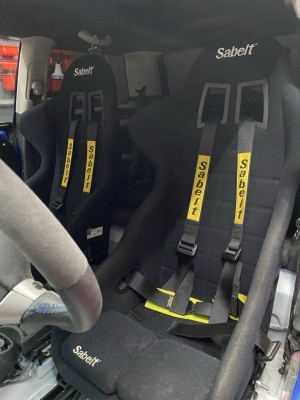

Sabelt Racer Duo XL raceseat
Lohen door cardboard
Lohen alu floor mat
Airifix3d shifter cover
Coolerworx shifter
Radio delete
Chameleon leds speedometer dial black/blue
Handbrake carbon/alcantara
Enginetix performance shifter display
VolantyCZ alcantara steering wheel
Alcantara roof ceiling panel

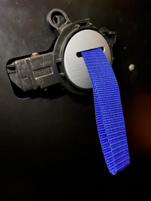

Roadie design door pulls strap
AST Motorsport half roll cage
Sabelt hanes 3point
53automobile floating dash aluminum
accessories:
MSA wire tow
Aerocatch front/rear
Orranje Led protector headlights
MWuk Led union jack tailights
JDH Challenge cooling brake Kit
Tiago Ferreira 3D print vent
FIA led fog brake light
Battery relocation Odyssey PC680
LED halo ring racing light

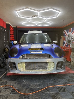

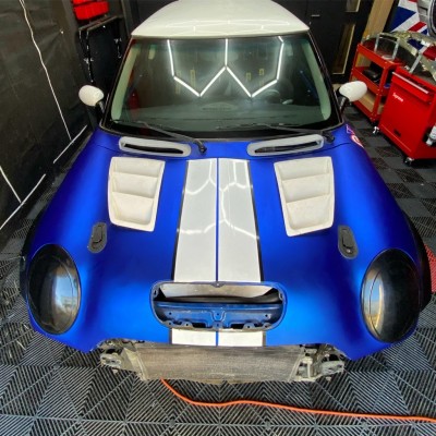

folie je Aliexpress za 3k, uz jsem mel lesklou, matnou a ted takhle... nejak to neresim, je to prece zavodak :andare:

tak tady si hraju, udelal jsem mu peknej pokojicek :D
vsechno si delam sam, bavi me to, a kdyz nevim youtube pomuze...

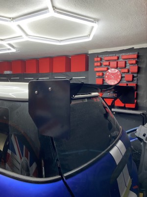

...mix fotek co jsem nasel, cely interier mam v planu vic odlehcit, ocistit a nalakovat na modrou... kabely procistit, zavodni baterku dat ke spolujezdci, pridelat poloram... pristi mesic ma dojit laminatova kapota a zadni dvere po pul roce....lexan okna uz mam pripravena na cely zadek... jeste me laka karbonova strecha, ale to bych musel vyndat predni sklo a je s tim dost prace a moc kilo to neulehci, lepsi by byly dvere z lamina plus lexan to bych usetril pocitam 35kg, ale neslo by stahovat okno a bez celoramu mi to prijde nebezpecny, prece jen plechove dvere pri narazu vydrzi vic... porad doufam ze vicemene to bude legalni na stk a budu s tim jezdit na okresky. Pokud by to neproslo, rozhodne dam celoram, laminat dvere a sezenu podvalnik :D Zajezdit si na Nurburgringu je muj dalsi sen, ale k tomu potrebuju na ty volne jizdy pro verejnost auto se znackama a svetlama, tak snad to nekdy dopadne :twisted:
